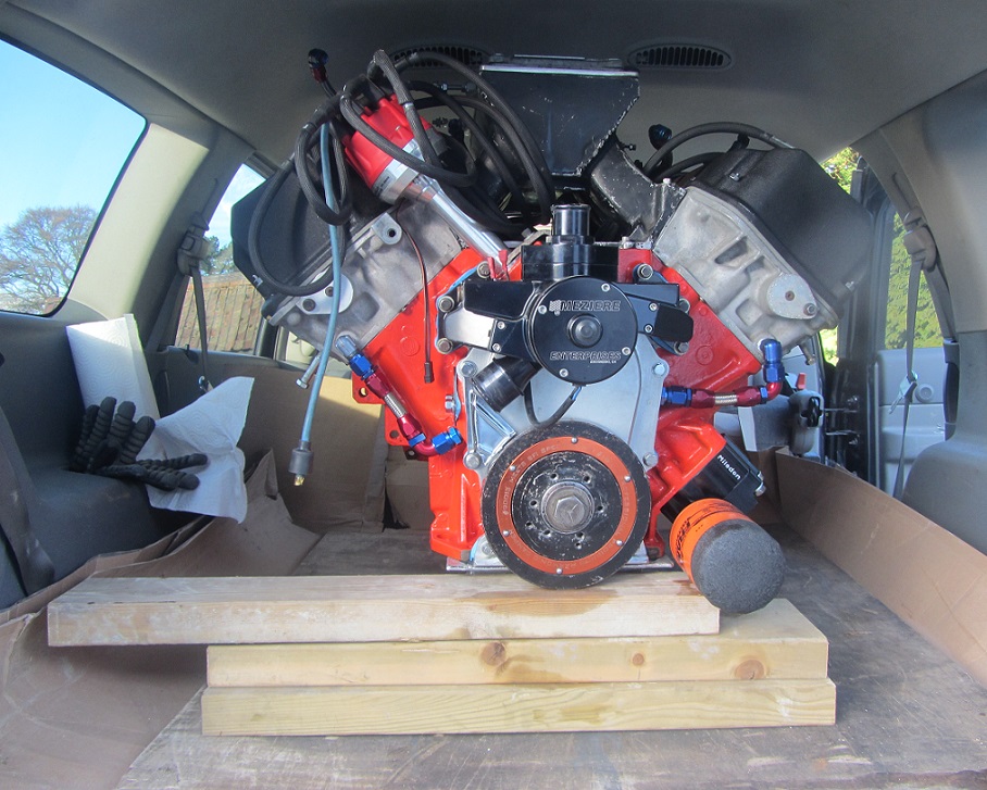

Picked up my engine after the ill-fated blow up about 2 years ago.
A very expensive and frustrating experience but all forgotten now as I can finally start building the Superstock Challenger up.
It will not be a match for Tig's Monster engined Challenger, but at least I can have some fun and dial in a half-decent time.
Yes, yes, YES!!! It REALLY has got a Hemi in it!!!! Just!
Hemi in a hemi.jpg (244.24 KiB) Viewed 10376 times

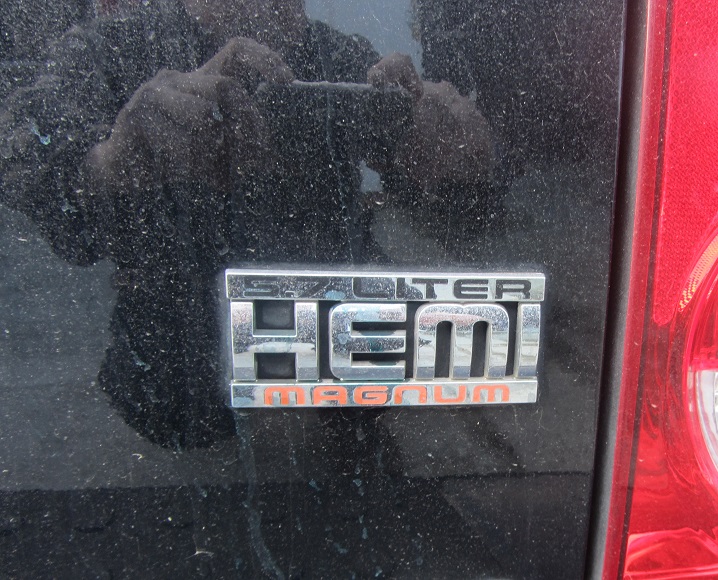

Yes, it HAS got a Hemi in it....
Hemi Badge.jpg (205.64 KiB) Viewed 10376 times

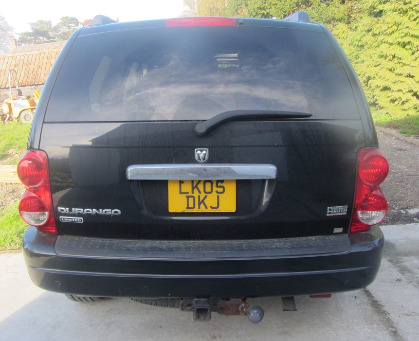

Here is old faithful after a trip Oop Narth....Bananarama! journey home mind you...

Thanks Gavin.
We hadto take the carbs off to get it in and it STILL did not fit.
Ended up taking the carb studs out of the manifold and it went in with a fag paper's clearance.
All dyno'ed up and ready for action.
:twisted: :twisted: :twisted: :twisted:

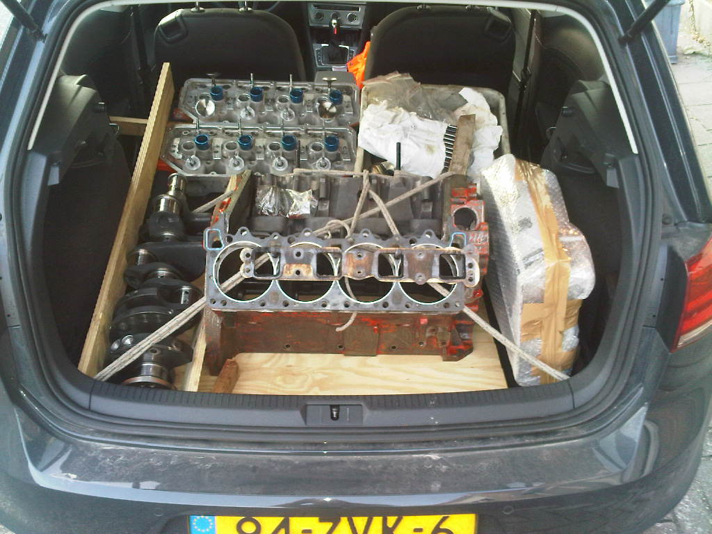

Had same issue.
But had 572 cui. Hemi in Volkswagen Golf.
Hemi in Golf
Hemi in Golf
Hemi golf.jpg (114.61 KiB) Viewed 10336 times

Posts: 22182
Very impressive, but try getting it in the car when it is assembled.
Dutchrunner
Posts: 40
Joined: Wed Jul 08, 15 6:12 pm
Post by Dutchrunner »
Assembled Hemi does not fit in a Golf.
Had to use transporter van.
What's your hemi specs?

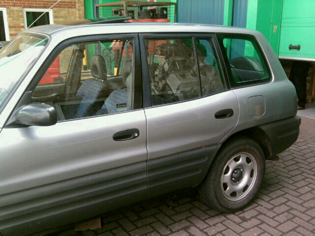

Posts: 13003
Well, we managed to get one in a Toyota Rav 4 complete with manifold and dominators, but you have to look closely!
Hemi in rav 4.jpg (115.98 KiB) Viewed 10271 times
Posts: 22182
I have no idea how you managed that, Ivor :shock: :shock:
