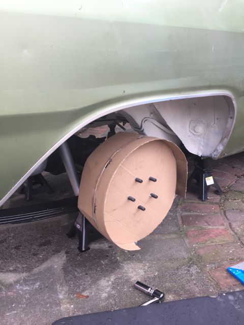

Yes I'm tempted to either make a wheel out of cardboard or tyy and find an old set of trashed wheels and tyres I can buy or borrow as a guide.

making up some cardboard wheels! Best way i can think of to make sure i don't order the wrong sizes.
cardboard wheel
cardboard wheel
