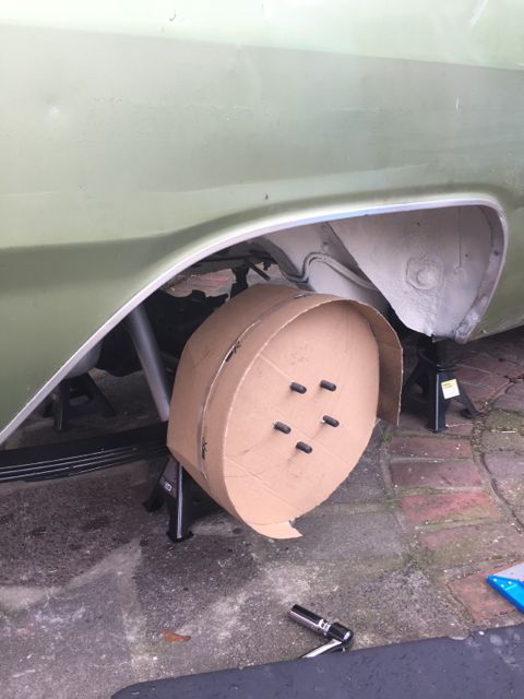

I need to measure it all accurately And I've found a lot of good websites that give detailed instructions for measuring wheels, but none of them seem to take into account that the sides of tyres bulge outwards and are not perfectly flat to the face of the wheel.
I could go for more modern wheels 17, 18's etc with flatter tyre sidewalls which would make life easier but I think I want to keep what I consider to be the muscle car look (personal opinion) of smaller wheel, fatter tyre with white writing.

Yes I'm tempted to either make a wheel out of cardboard or tyy and find an old set of trashed wheels and tyres I can buy or borrow as a guide.
It's a shame wheel/tyre companies don't offer this but I'd imagine there are so many different wheel & tyre combos that it's just not feasible

making up some cardboard wheels! Best way i can think of to make sure i don't order the wrong sizes.
cardboard wheel
cardboard wheel
