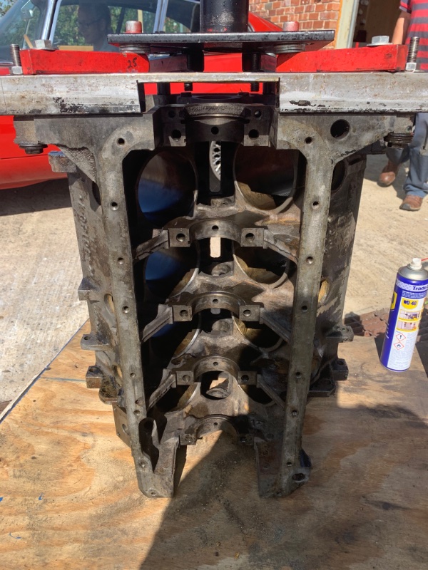

Slow but steady progress. All the required parts sourced from the States, engine stripped, block dipped and sent off for reboring. Thinking ahead, I’ll want the rebuilt engine tuned and dyno’ed so I have a power and torque curve to give to Burns Stainless so they can design my custom headers (none of the off the shelf header options will fit in an Interceptor). Can anyone recommend an engine tuner with an engine dyno in the West of England (Oxfordshire, Gloucestershire, Wiltshire, Somerset, Dorset) or in South Wales who could do this work? I’d go to John Sleath in Doncaster normally, but lockdown might make this tricky...

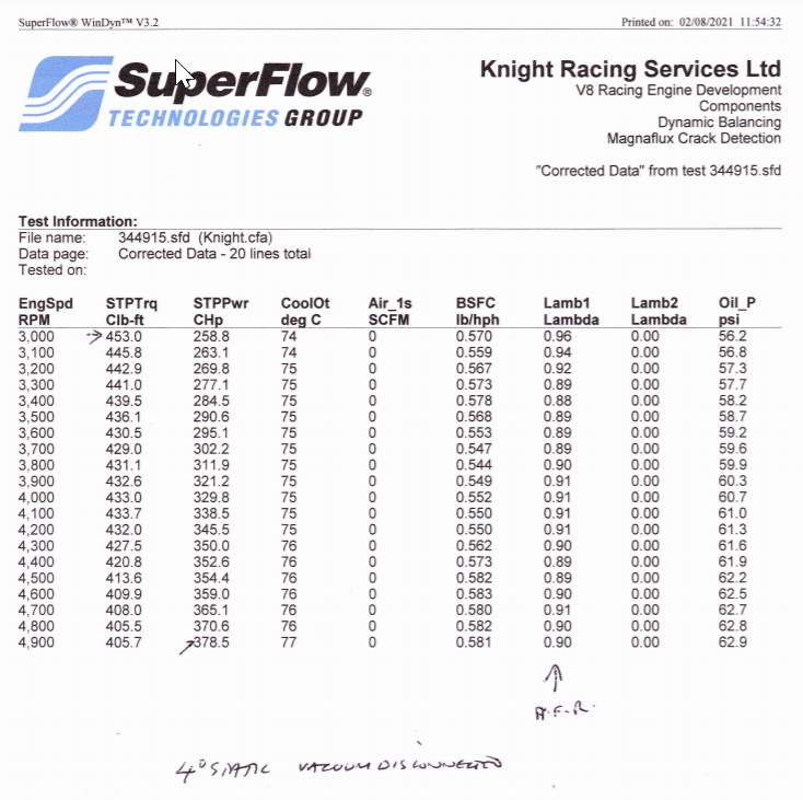

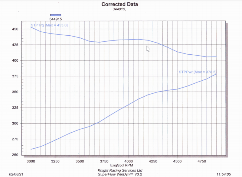

Just got the dyno results back from Peter Knight. Please see the below. To be honest I'm a bit disappointed with the power, was hoping for mid to high 400s. A quick reminder of the spec:
383 stroked to 432 with 0.030" over pistons
Ported 906 heads with 2.14" intake valves
Head gasket selected and head milled for 9.73:1 static CR
XE274H Comp Cams camshaft, 230/236 duration at 0.050" lift
Edelbrock AVS2 800 cfm carb
Any thoughts?

Posts: 14646
Re: 1969 Jensen Interceptor drivetrain upgrade
Why only 4900 rpm? Looks like the cam is only just getting into its stride, would probably be making over 400hp by 5500RPM.

Pete always stops the test at 5000rpm on big block Mopars, apparently...

Post by MrNorm »
That is super low rpm, you can see from the power curve that it has not peaked at all. I'm not a big block guy, but that cam seems too large if you don't want to go above 5000rpm. Or put another way, with that cam you need to keep going up the rpm range - even the comp cams specs for it say 1800-6000rpm. And for a properly built motor you shouldn't have any trouble going quite a bit higher IMHO. My 2c

Post by NigelK »
I think my slight disappointment with the power figure stems largely from the factory 335hp rating for the 4-bbl HP 383. But it seems this figure is more hope than reality, and that from factory 260hp peak was more realistic. So I should be happy with a 50% increase to 379hp! Plus 450lbs/ft of torque at 3000rpm will be great for driveability.
I chose the cam based on Comp Cams' own recommendation - I'm happy to go above 5000rpm if road conditions and the A727 permit.

I agree with Blue on the Oil pressure. In fact yous is not that high for a high Pressure pump - maybe because the rpm was low on the dyno.
Mine made 98psi at 6800rpm on the Dyno with a High VOLUME pump, not a high pressure one.
Blue and I put an adjustable Milodon pressure valve in it, and it is now as Blue says.
The best Rear seals in my opinion are the Mancini ones. Dave Billadeau will be able to advise on this.
It is unfortunate that the dyno run was stopped before the Two lines bisected. They always cross at 5250rpm.....
