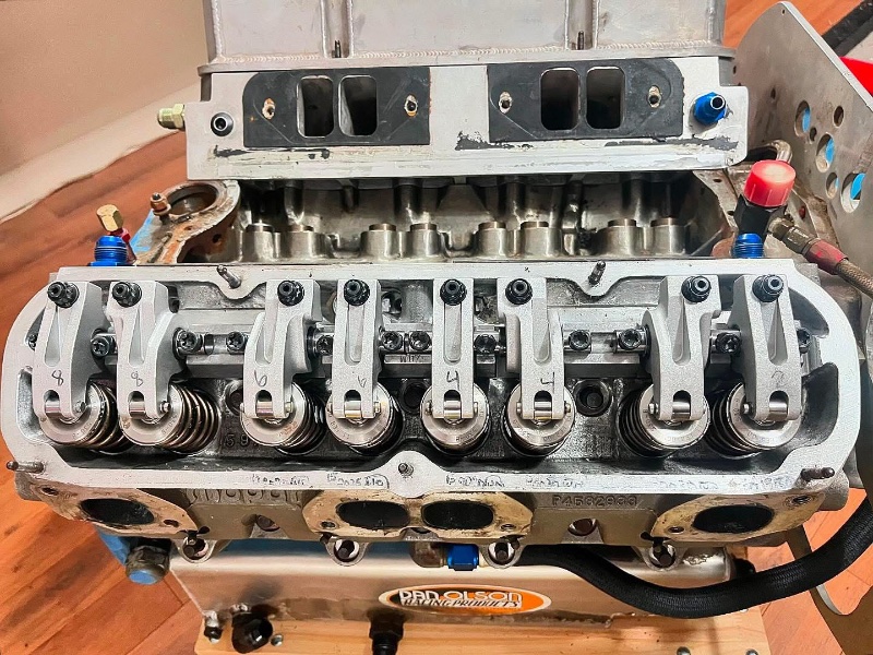

From a cost point of view if you need more flow you are better off going for Trick flows. At around 300 CFM they are currently the best flowing “bolt on” heads available although you do need custom pushrods due to the longer valves but they do retain the standard pushrod location. Unless you can port your own heads the cost is prohibitive these days. There is a fair bit of head choice for small block Mopars nowadays but things get very expensive very quickly if you are wanting to go beyond the Trick flows.
W8 heads are probably the last word in heads for an LA based small block, custom intake, custom headers, custom rocker gear and so it goes on, big power at an eye watering cost
