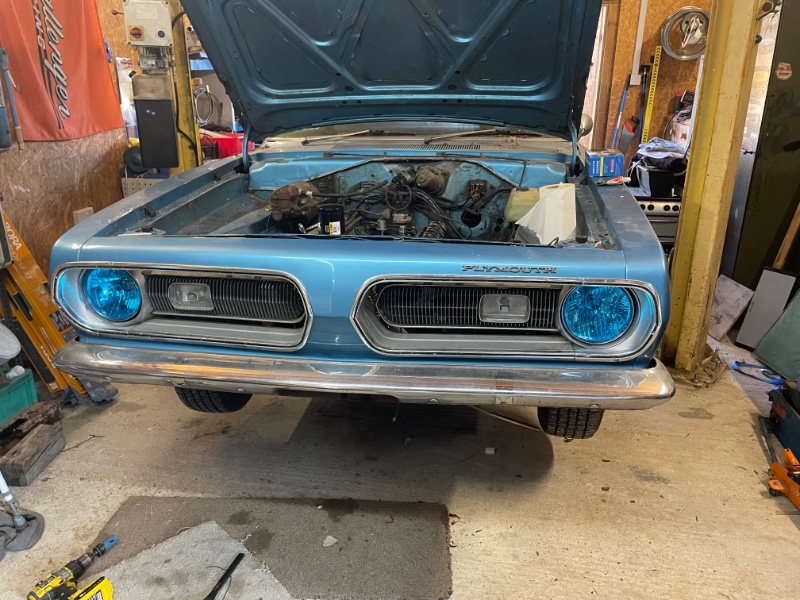

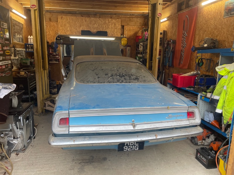

Other work has got in the way and the car had to go back into storage for the last 9 months. It’s back in the operating theatre now and work has recommenced.

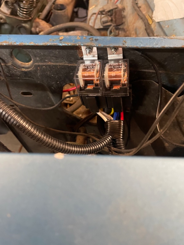

Started with the usual halogen headlight conversion with my favourite Wipac plastic headlamps. I found a plug in relay conversion on the Bay, very neat way to do it and non invasive. Trans cooler next…

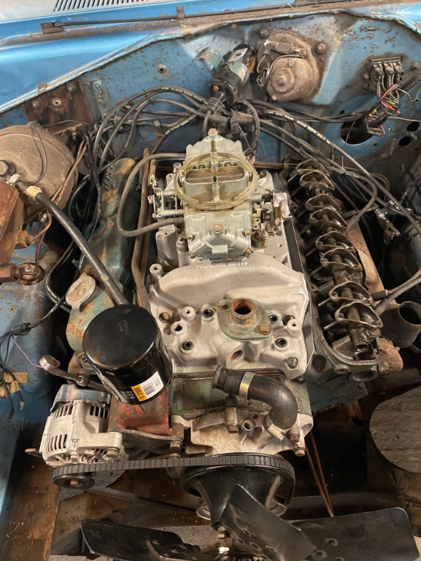

Bit of a rummage through the stash turned up an Edelbrock performer and a 600 double pumper so fitted those…

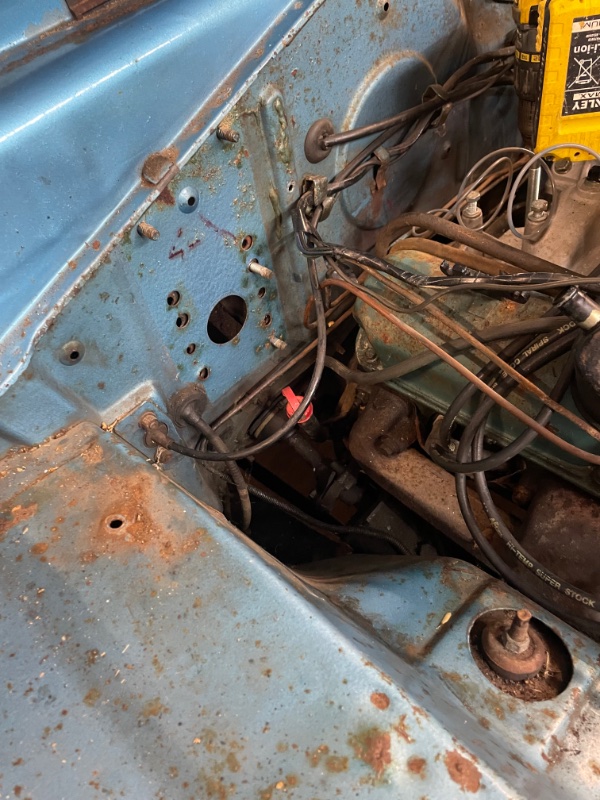

I hate American power brakes anyway but when it’s a monstrosity like this blocking access to everything on this side of the engine it was on my to do list. Whilst struggling to work around it the front brake pipe broke off so it went to the top of the list…
Posts: 14582
Re: And another RHD Barracuda…
First job is to replicate the original mount with an adaptor made of 1/8” ally plate. This picks up the pedal box mounts and additional bracing points and allows me to fit a manual master cylinder in the correct location. Mopar master cylinders have pipe exits to the right, straight into the valve cover if it’s RHD. The only exceptions are Superbird/Daytona and some Hemi cars, not going there. Bit of reasearch brought up a Dorman M98908, correct bore size, connections on the left and readily avilable. Original application is 1980s Lincoln/Ford, 2 bolt mount rather than the usual Mopar 4 bolt.
Weirdly the pedal box already has 2 bolt holes in the correct location for the Ford Master so I assume manual brake RHD cars used something similar.
