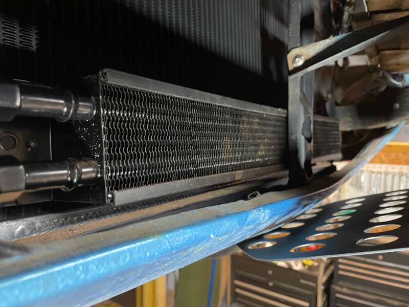

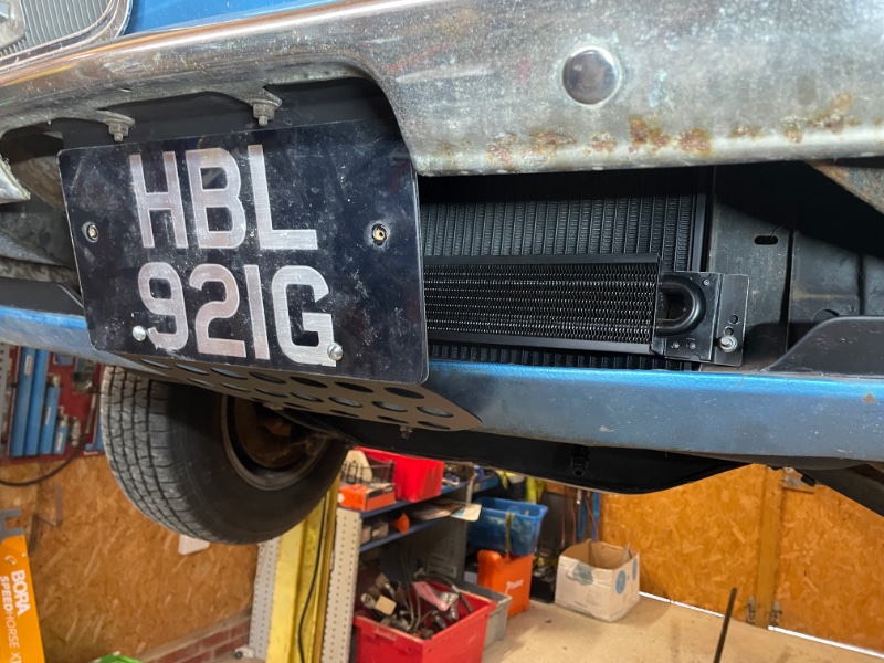

I have a 2800 stall convertor to fit so a bit of additional transmission cooling isn’t a bad idea. I don’t want the trans running stone cold either so the fluid goes trough the standard cooler in the bottom of the rad and then through an auxiliary cooler mounted out front. 5/16” Kunifer for the hard lines following the original route along the side of the engine oil pan changing to AN6 PTFE lined hose to link everything up.

I made a new license plate bracket suitably ventilated so as not to restrict airflow to the long Derale cooler.
Posts: 7132
Re: And another RHD Barracuda…
Plenty of 'oles, exactly as expected. :lol:
Coming on nicely, really looking forward to seeing this rolling again!

Post by mygasser »
Blue wrote: Fri Jan 09, 26 3:22 pm I made a new license plate bracket suitably ventilated so as not to restrict airflow to the long Derale cooler.
who you trying to convince? you just couldn't fit something without lightening holes :thumbright:
