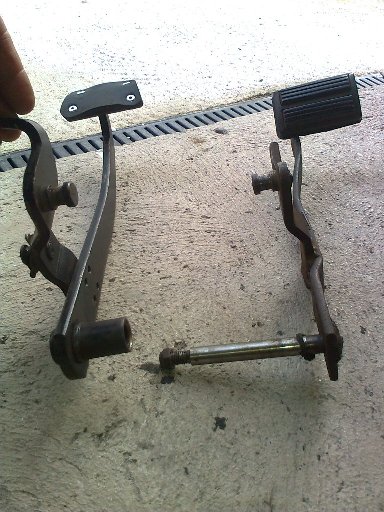

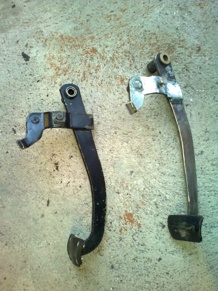

I've also been making my clutch pedal, thanks to Ade for donating an A-body one as a donor and thanks to Anton for the loan of a correct B-body one to copy.
You can see the differences in the pics.
I've flattened out the main lever, Made the rod pivot out of a cut-down bolt which i'll weld in along with the spring pivot which the old pedal donated.
The cross-piece was tricky cos of the thickness of the steel and all the bends but a blowtorch, lump hammer and vice got it sorted!
The pedal pivot i'm getting 'engineered'- Instead of roller bearings we're going for oilite bronze flanged bushes. He's turning a sleeve to suit and will then weld it into the pedal. It might be done today...

Another big push today, I now have a WORKING CLUTCH!!!
Terry, my engineer mate, made the pedal pivot last night.
He welded the tube into the pedal then pressed in the oilite bronze bushes.
I welded the rest of it together and gave it a blast of gloss black.

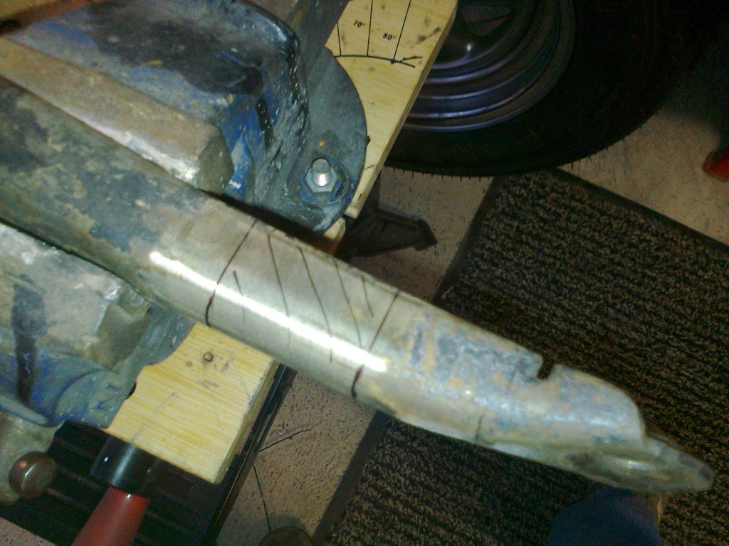

Next up was the Z-bar.
From my trusty Kellogs pattern i hacked up a bit of 2x2" box and with some serious heat bent it into shape. It needed bit of tweaking to get it snugly into place and level, then it was out with the welder again
It's not as close to the brake pipe as it loks, by the way

Once the Z-bar was in, i could measure the clutch fork properly. I needed to chop 1.5" out of it.
After welding the two halves back together I plated over the open side to beef it up a bit.
