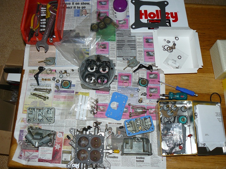

I've stripped the new carb- I did try banging it on the car straight out of the box but fuel pi55ed out. I only realised when I had it half stripped that one bolt was missing out of the rear fuel bowl- that would explain the leak then...
I'm happy to rebuild it though- the old gaskets would never cope with coming apart for jetting changes, etc and I'd expect the seals to have hardened.
I'll get the old carb properly jetted and running right before I try the dp just so I have a baseline to compare it with.
My old carb has Maxjets so I've had to do a conversion to work out the equivalent Holley jet sizes.
I've wired the secondaries shut and gone up from 70.25-ish to 72. I'll wait til the roads are a bit cleaner before I take it out tho, they're white with salt just now!

I've got stuck into the new carb- all stripped and I have the kit ready to rebuild it.

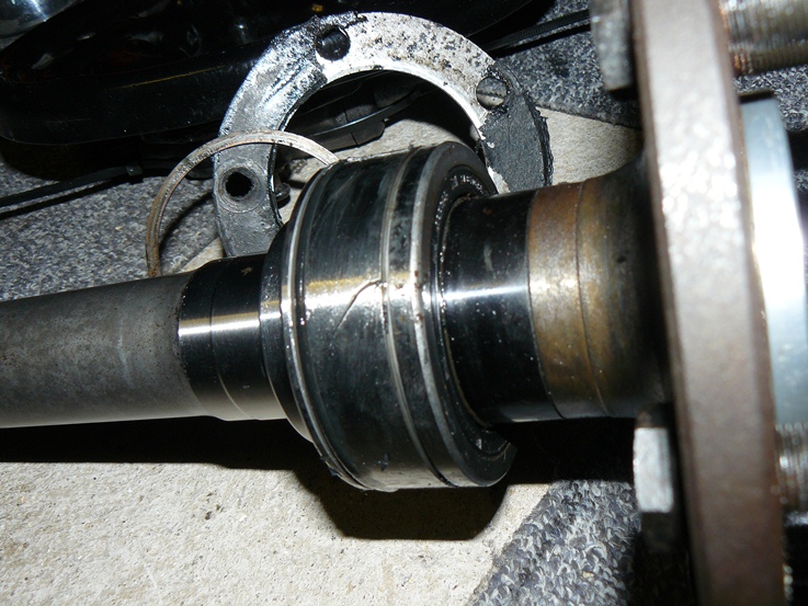

I pulled the rear wheels off yesterday to get them balanced and I found some fluid in the hubs. Fluid is not only coming out of the overflow but from the end seals too!
I've also found a bit of metal powder on the magnetic drain plug
Luckily the gear faces look perfect.
I can only imagine some swarf or weld spatter was stuck inside from when it was made and I didn't clean it out well enough!!
I'll give it a good flush out and replace the fluid.
I'll fit a proper vent.
Don't know what to do about the seals though... They're brand new and I can't see any damage or any reason for them to leak unless they were faulty... Any ideas?
- 03 Bearing.jpg (211.66 KiB) Viewed 1228 times
- 02 Axle split.jpg (218.46 KiB) Viewed 1228 times
- 01 Axle out.jpg (210.55 KiB) Viewed 1228 times
- 03 Ready for rebuild.jpg (220.31 KiB) Viewed 1228 times
