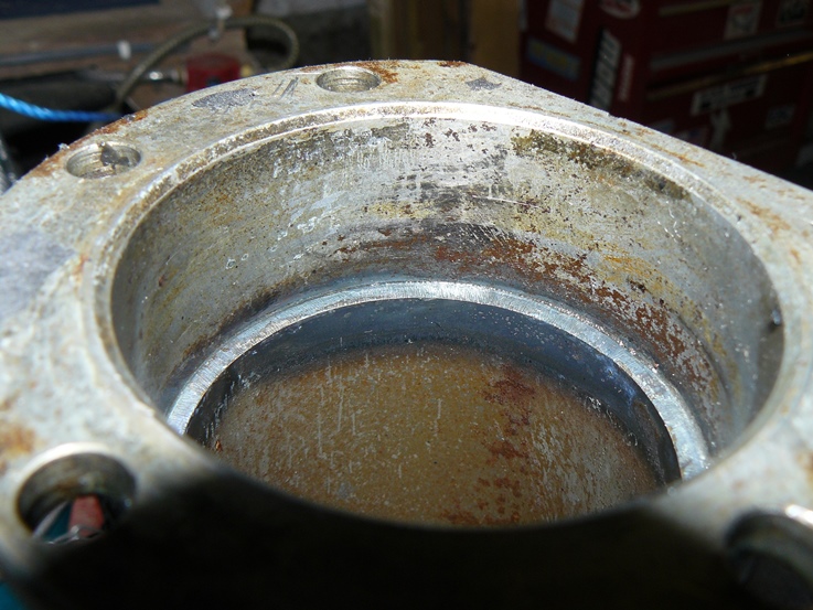

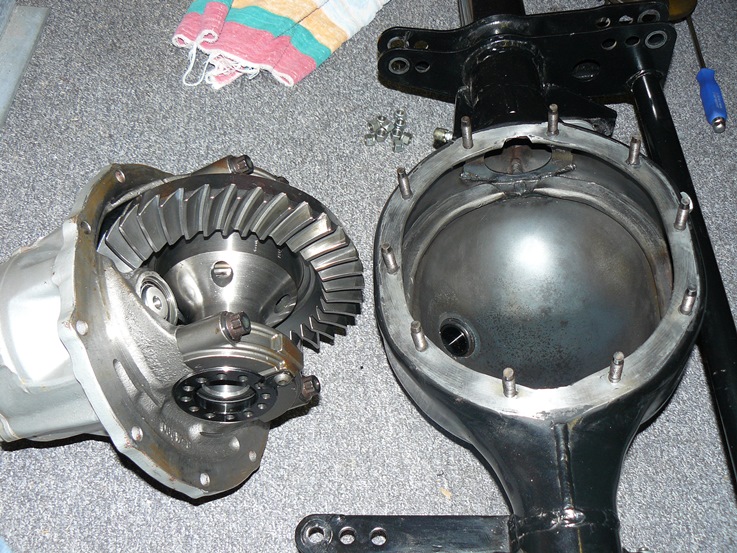

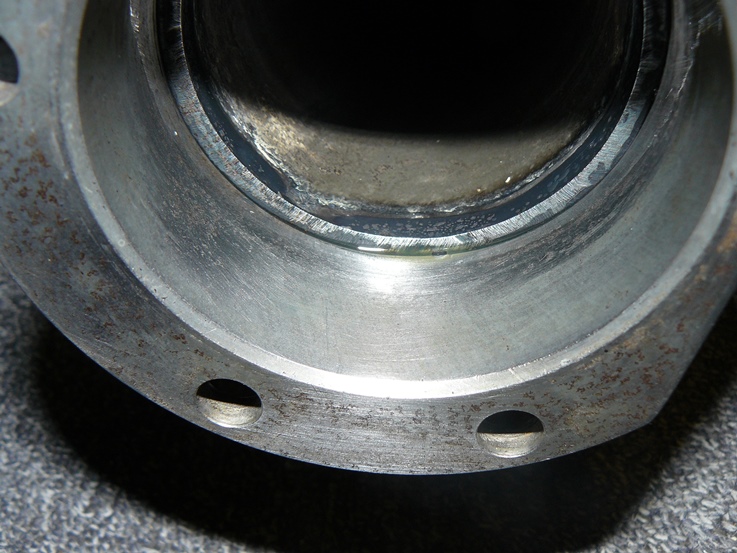

Axle update-
Having been horrified by the price of Green bearings (almost 90 quid the pair!) I investigated further and found the axle case had rust patches right where the O-rings sit!
I've cleaned them up carefully with Scotchbrite and although the O-rings don't look damaged I'll replace them.
The fluid was pretty contaminated and there was swarf on the magnetic drain plug, so it's all had a thorough clean out :thumbright:
Axle clean & ready 01.jpg (210.18 KiB) Viewed 987 times
Axle case end cleaned up 01.jpg (177.92 KiB) Viewed 987 times
Axle case end corrosion 01.jpg (193.89 KiB) Viewed 987 times
