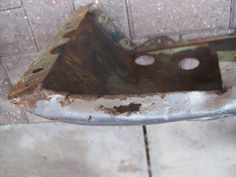

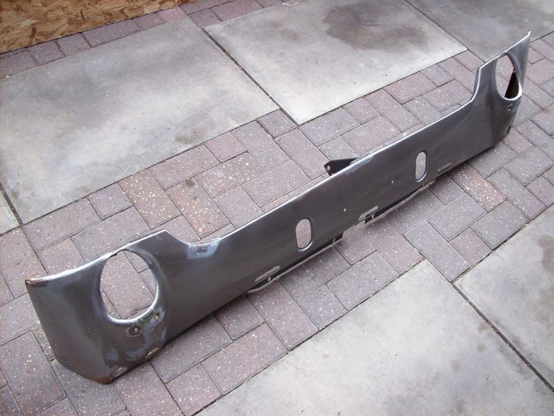

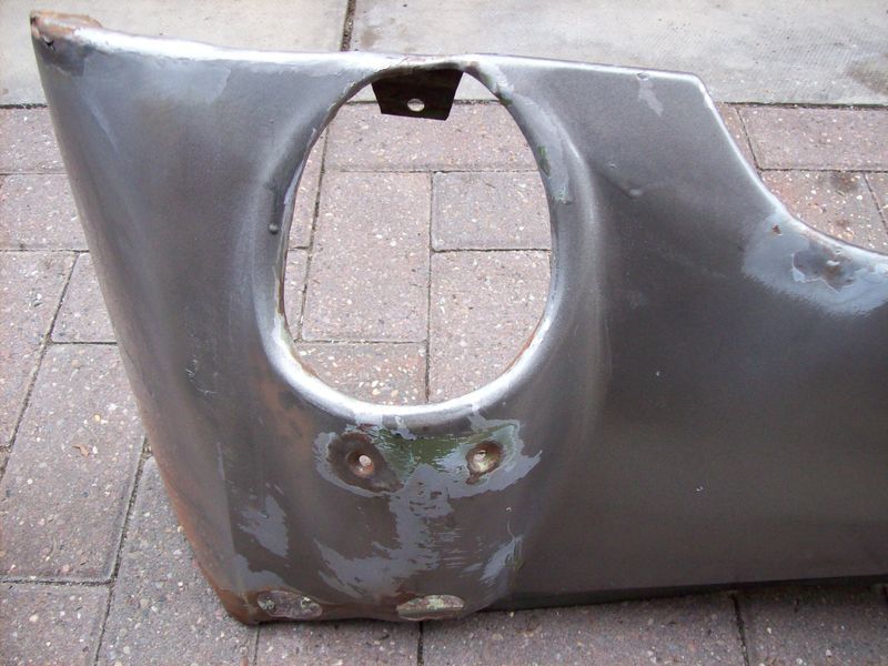

the front valance had always bugged me a little, was a bit scabby and over 40 years looked like it had been used as a parking aid on a number of occasions
as it is relatively straight forward to remove I decided to do so and get it repaired and painted, rather than doing it in situ and it snowballing into painting the whole car
so off it came and away with it up to Dave (Moparnutterz) in Chorley for sorting out

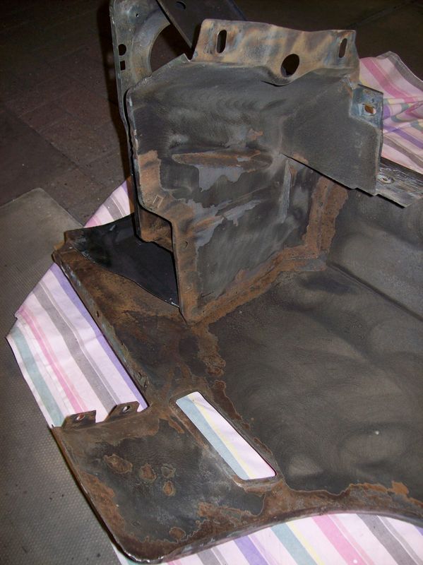

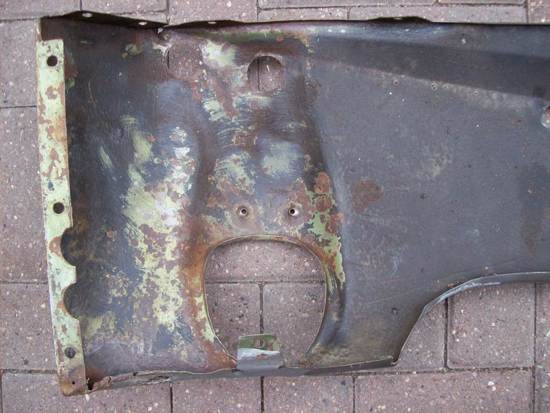

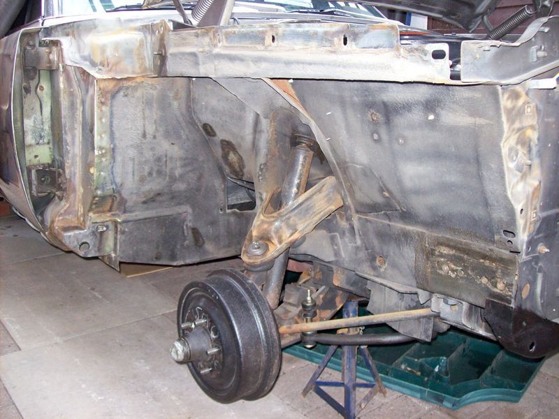

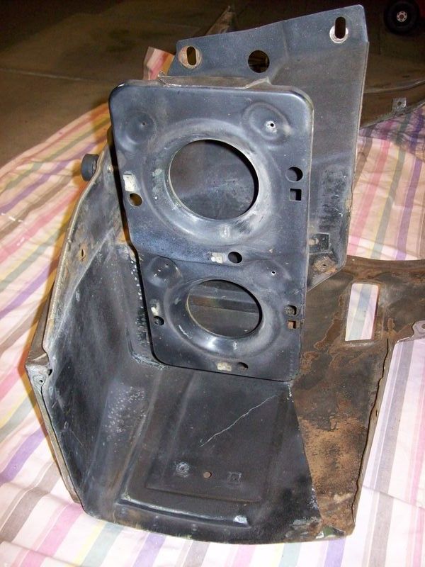

decided to take off the front fenders to check for rot and treat any areas not possible to reach with them on
pleasantly surprised to find only a little surface rust
both scuttle panel drains blocked with old rodent nests, I guess that’s why I used to get wet feet when the car was out in the rain, seems to be cured now
Posts: 7149
Inside of the fenders look really clean Si..........I take it its a dry state car?
Rats Nest insulation.........Interesting Mod! :D

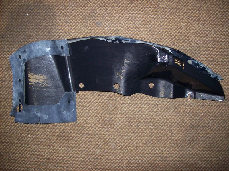

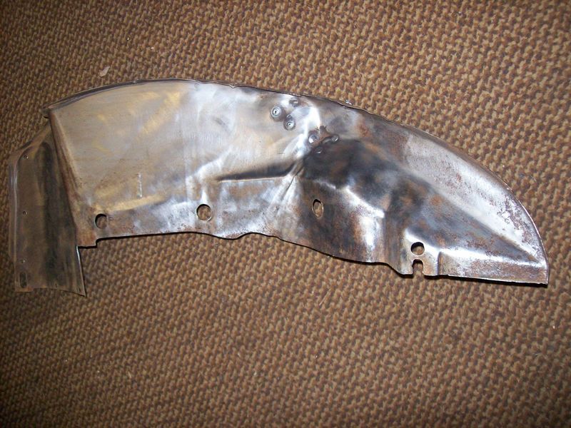

other bits and pieces cleaned and painted in the process

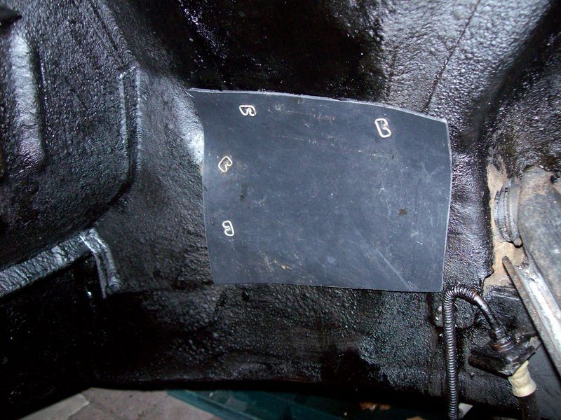

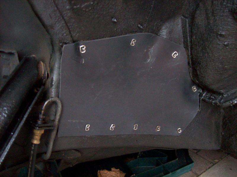

I made the upper control arm cam bolt access covers from an old recycling box

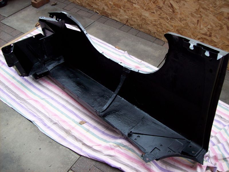

Posts: 5254

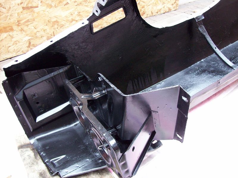

cleaned, treated rust and painted the inside of the fenders

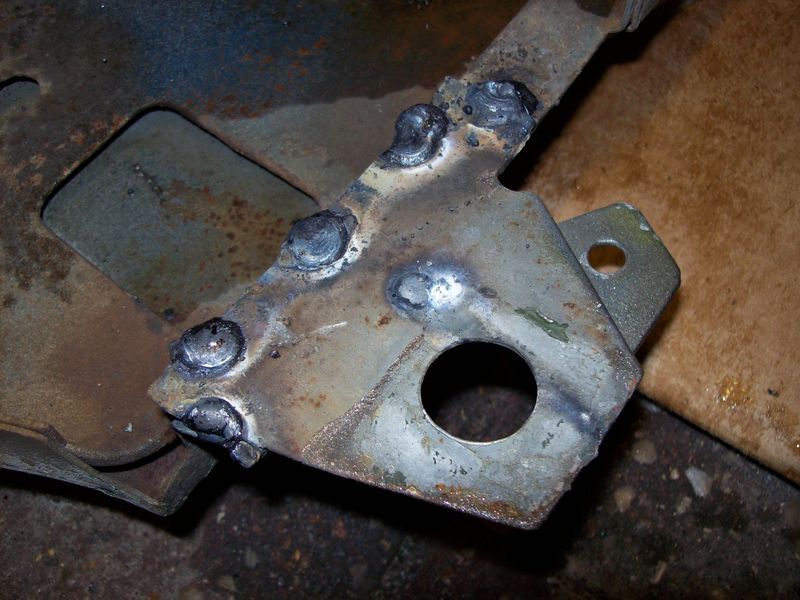

a little welding to re-attach the passenger side upper rear bracket

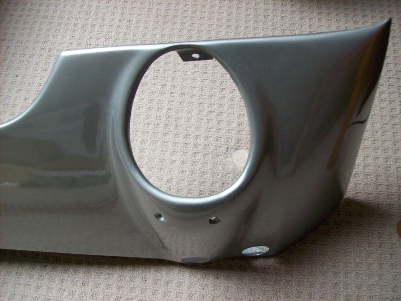

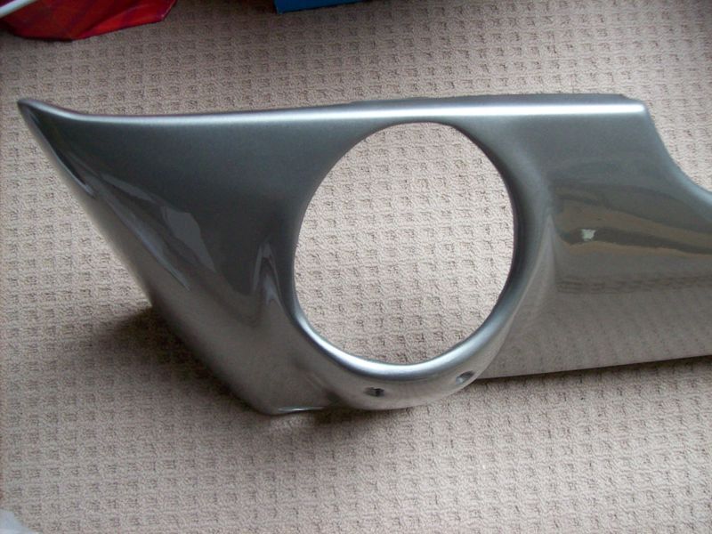

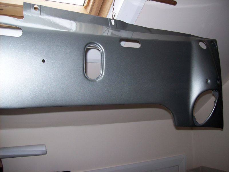

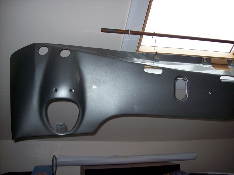

Posts: 5254

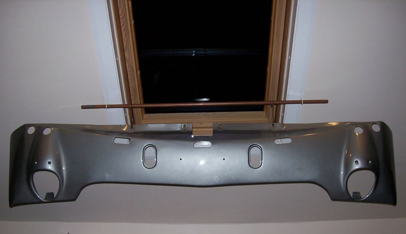

repaired and painted valance panel back from Dave

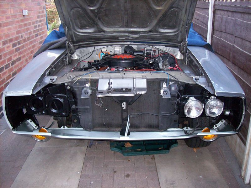

apart from the scabby valance I guess I could have just left as is would have looked ok, but while I had the valance and bumper off seemed sensible to take a look under the fenders

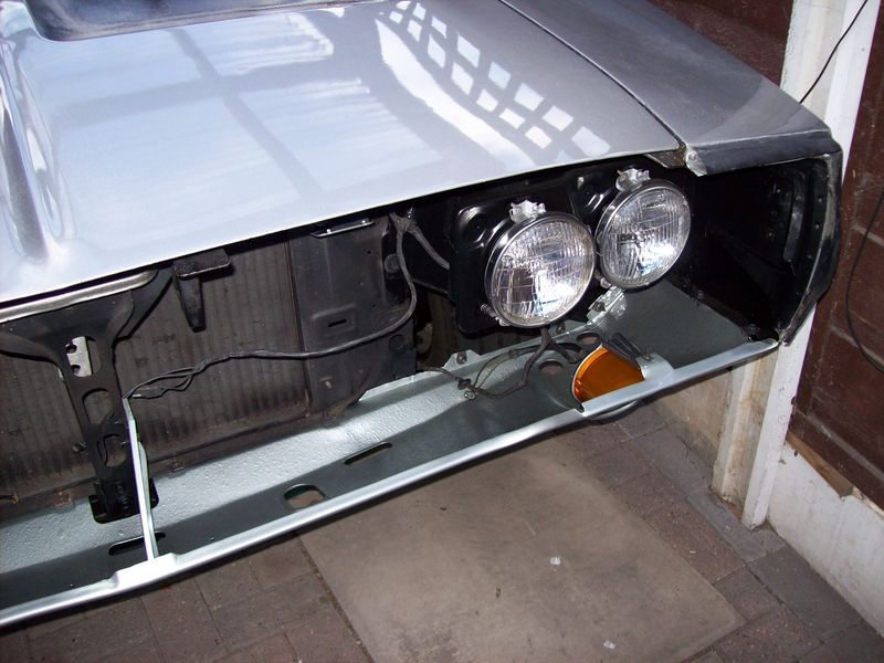

Posts: 5254

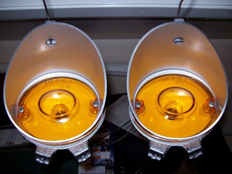

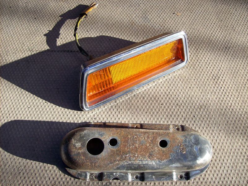

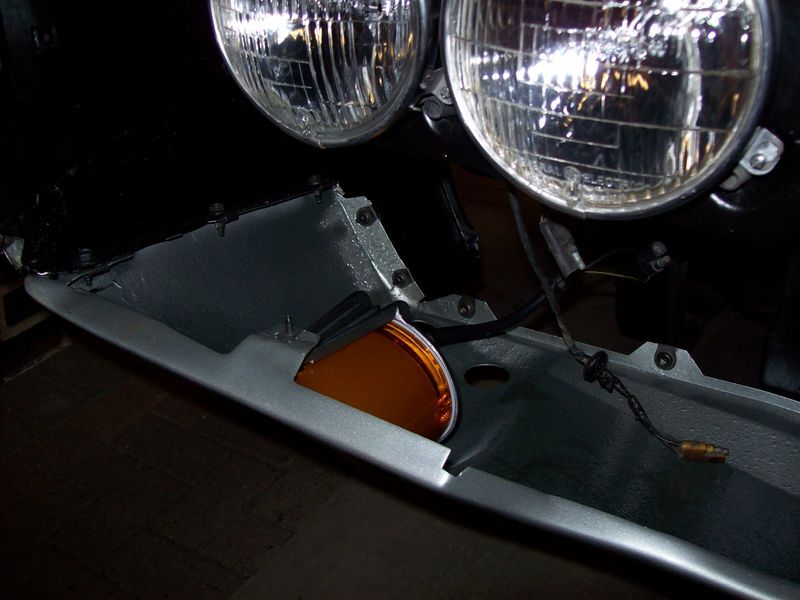

park & turn signal housing cleaned, painted and fitted, new lenses from PG Classic … http://www.pgclassic.com/

Posts: 5254

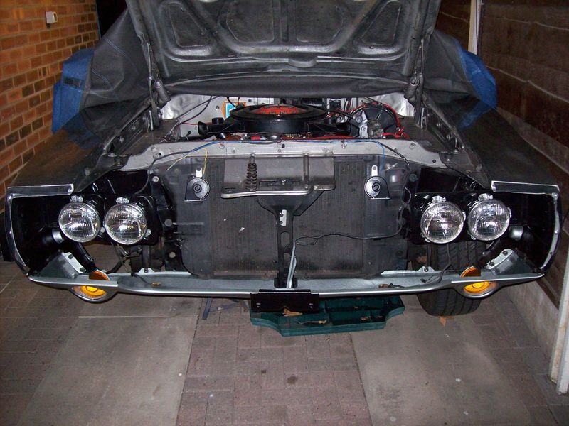

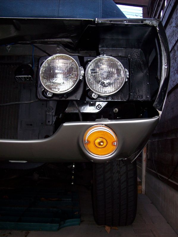

reassembly
getting everything lined up again with nice panel gaps was easier than I thought it was going to be
