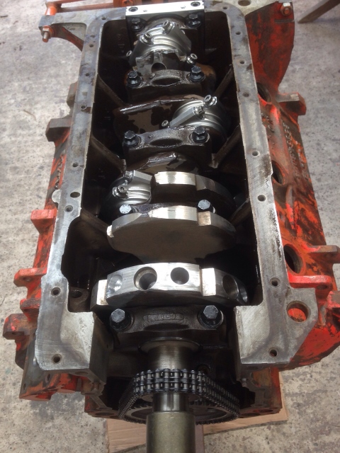

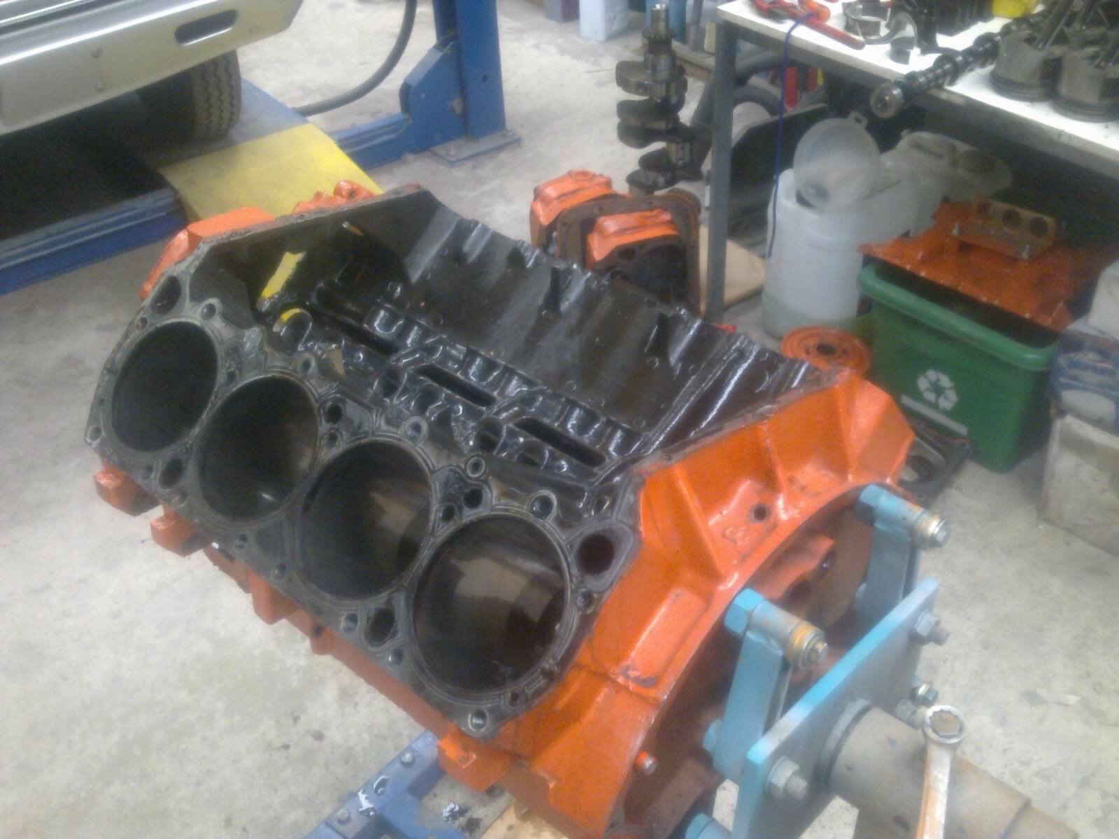

Verdict from Dave, it's worn out all over. No super obvious origins of clanking noise, just lots of wear. Good news is that it's a standard HP block and it looks like this will be it's first ever rebuild.
Posts: 22109
At least you have a very usable core and it will come back better than ever.
I would always refresh whilst the engine is out as it is peace of mind and could save a ot of heartache..
Stroker motor???? :evil: :evil: :evil: ;) ;) ;)

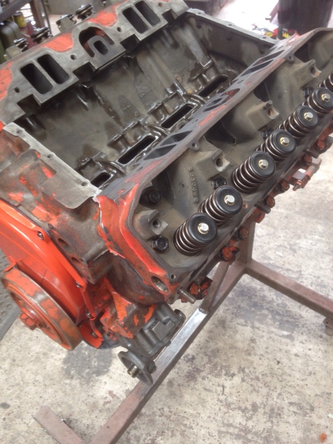

Hemimad
Posts: 310
Location: Chester
Post by Hemimad »

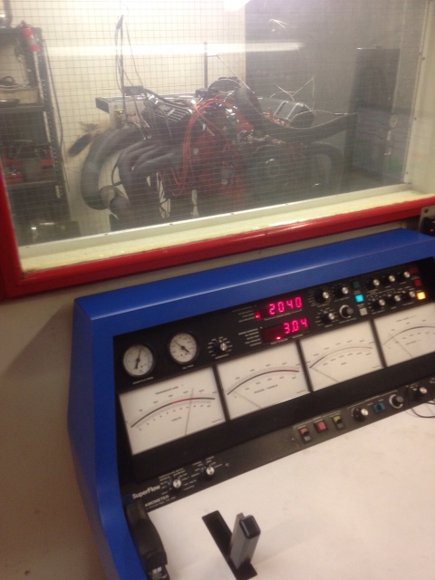

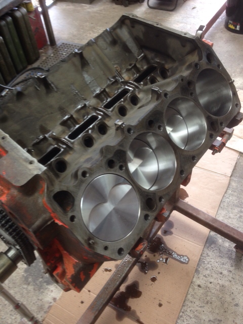

It's all back together, Dave has done a grand job and thinks I might notice the difference! Quite a few upgrades internally and new ignition should see a vast improvement, just got to collect it and drop it in, hopefully back in action next weekend........
