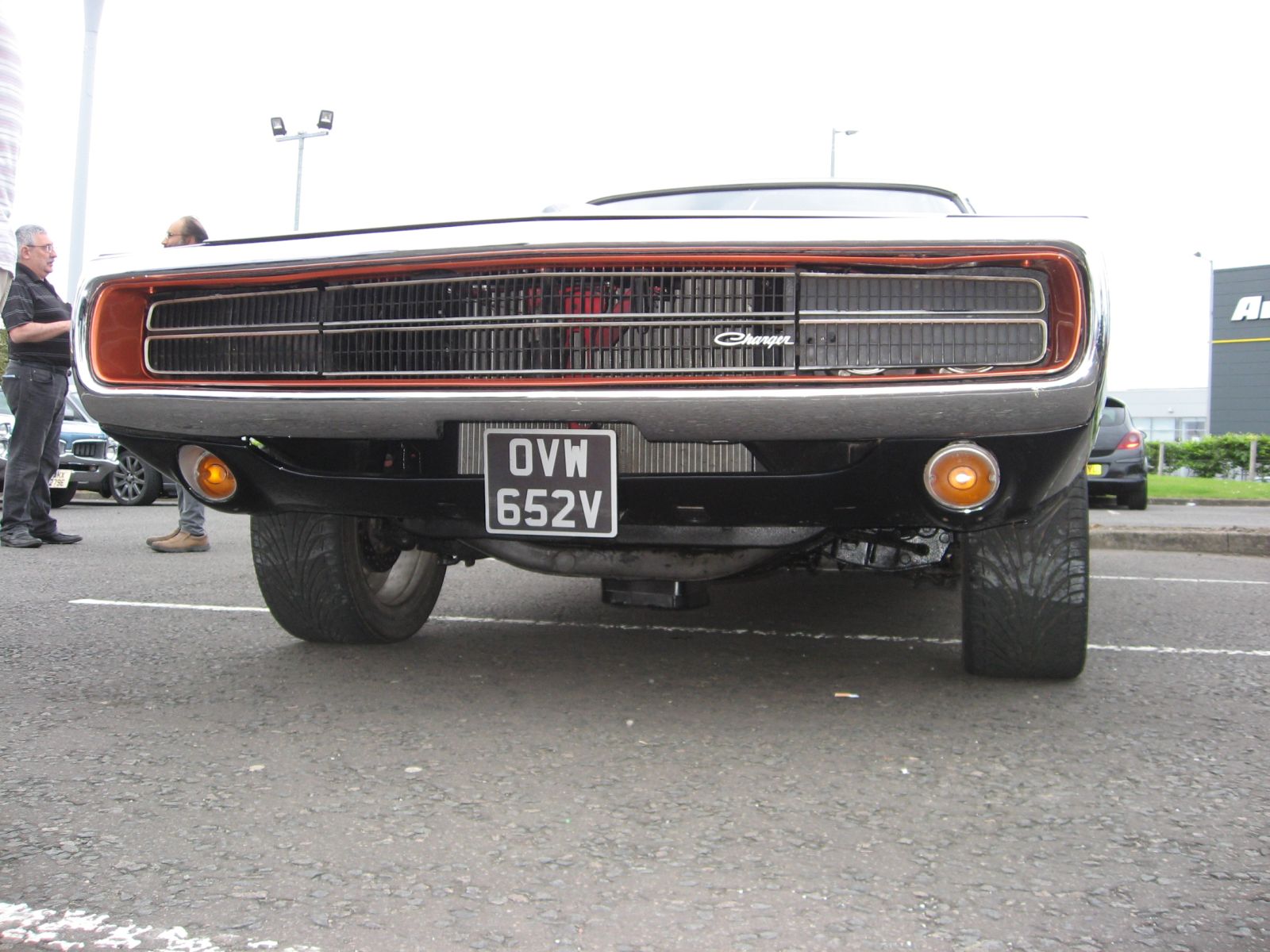

having recently bought a 1970 charger with the 383 engine i took it out for a run on the back roads around here and managed to touch down with the sump as it has been fitted with a deep sump so it hangs way down below the cross-member.
my question is what would be the reason for having such a deep sump fitted over the original sump as im thinking about changing it back to original.
Secondly where is the best place to get a replacement inc gaskets etc?
