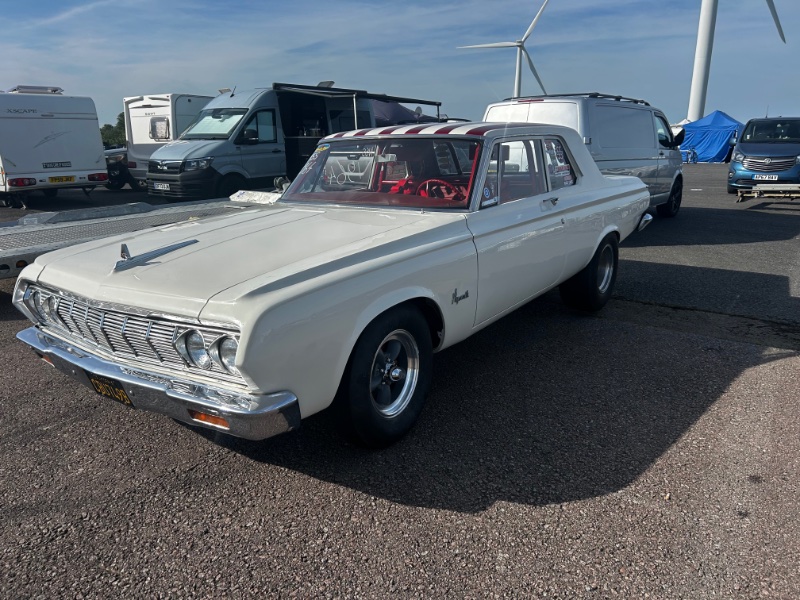

Well that was eventful! Over 60 entries but then the attrition started like I've never seen in the class before. John Davidson unfortunately hit the wall in his Roadrunner, fixable but properly bent. The Mopars of Don Scott, Stewart Arthur and Billy Mills all chucked rods out ending the season for them, Gary Cork broke his diff in his Super Bee. There were other less serious casualties as well so by the time eliminations starters I think we were down to 52 cars.
I had a couple of issues myself, fuel pump cutting out was the first. a quick check showed one of the terminals for the relay had pushed out of the mounting block leading to intermittent operation, easy fix.
The second was the car started cutting out after the burnout, and intermittently in the shutdown area. I knew what that was going to be as I've had this on the road when the weather is stupid hot as it was at the weekend, crank sensor overheating. After a bit of head scratching the fix was a damp rag left in the freezer cable tied around the sensor just as we were called to race. worked a treat, no more issues with that.
What I did struggle with all weekend was trying to dial the car in with the extreme heat, wind, no wind, suns gone in ooh it's a bit chilly. That saw me out in round one when I ran slower than my dial in against a car that was running bang on all weekend. He eventually lost running 100th of a second under his dial in, the top end of the class really is that close.

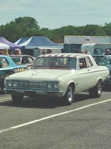

This is what a losing run looks like...
