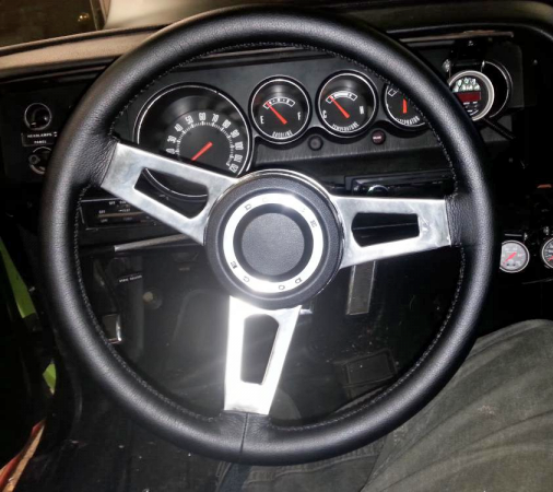

Tuff steering wheels also fit, good quality and leather though they're pricey. https://pgclassic.com/256-bs-c-mopar-a- ... ing-wheel/

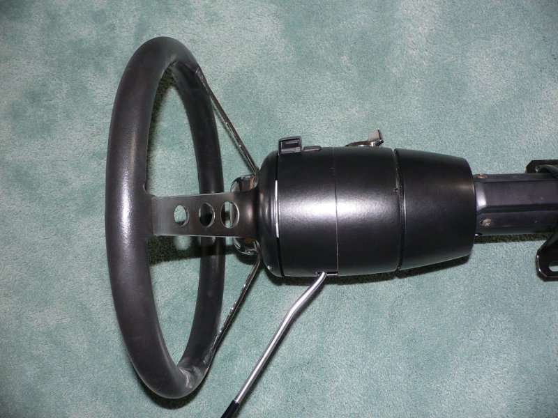

Yes, you can dispense with the crush can. Here's a pic of my column with Grant wheel, no crush can, and Challenger column cover (the curved dish). The only thing I had to do was to bend the indicator lever as it caught my hand when driving. YMMV

MrNorm wrote: Fri Jun 12, 20 2:48 pm Yes, you can dispense with the crush can. Here's a pic of my column with Grant wheel, no crush can, and Challenger column cover (the curved dish). The only thing I had to do was to bend the indicator lever as it caught my hand when driving. YMMVP1040731.JPG
Exactly the same set up in the Race car, with the exception that I bobbed the Indicator stalk.
Customville supplied the correct Boss for me... they als odo an "Intermediate" length can if you wish too (In fact I have a spare one...)
