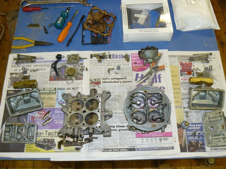

Well good old Real Steel got the rebuild kit to me next day, so i spent a pleasant Saturday evening stripping and cleaning :)
It wasn't bad at all inside, just hardened gaskets from age and some crud washed through from the fuel pipes.
I've tried to i.d. the carb but i think it's a bit of a hybrid, Holley didn't make a 750 vac sec with 2 corner idle screws, 2 metering blocks and no choke horn. The only problem is that i was short a couple of gaskets in the rebuild kit, luckily the old ones were good.
I checked the floats were good too.
It's now all back together, baseline adjustments done and ready to refit.
In case anyone's interested...
Primary jets are .072, Sec .086
Idle mix screws 1 1/4 turns out.
Squirter pump 30cc, jet 31
Throttle blades 172
Power valve 65
Carb stripdown.jpg (252.28 KiB) Viewed 673 times

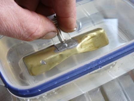

Float testing.jpg (33.47 KiB) Viewed 673 times

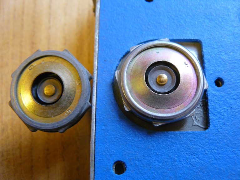

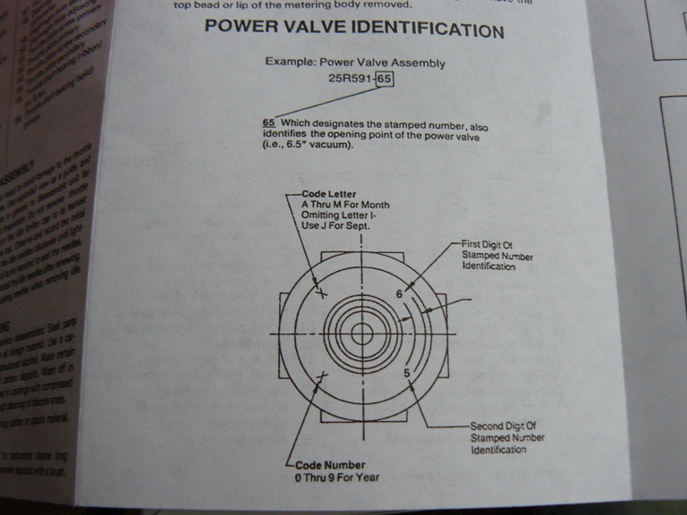

I just had a bit of doubt so had another look at the powervalves...
The old one is stamped 65 but the new one, despite being genuine Holley and coming with a little diagram to i.d. it... hasn't got anything stamped on it :? There's a faint hint of what could be a 6 and a 5 and as best as i can measure externally they seem the same. Bloody annoying!
Cheers for the advice. I'll bang the carb on tomorrow cause i want to know that fuel leak has stopped but i'll get a 2.5 before i try to set anything. :thumbright:
power valve i.d..jpg (222.37 KiB) Viewed 786 times
power valve.jpg (242.42 KiB) Viewed 786 times

Default shipping is 6.5.
The lower the figure the lower the resistance in the spring, nowt to do with diameter, etc............

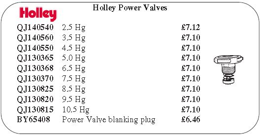

Real Steel list the full range of pv's, I'll order one tomorrow
RealSteel Power valves.JPG (36.89 KiB) Viewed 770 times
